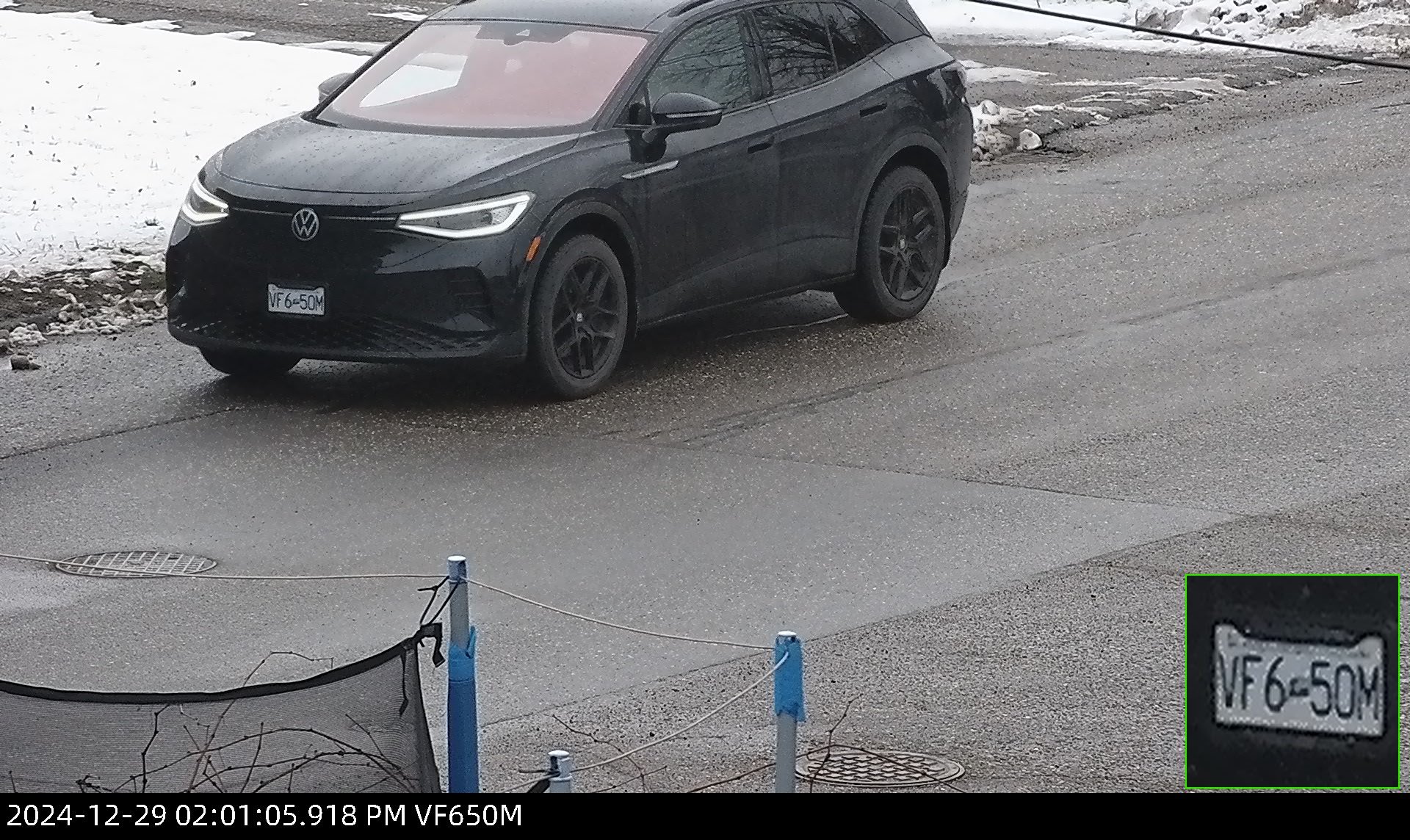

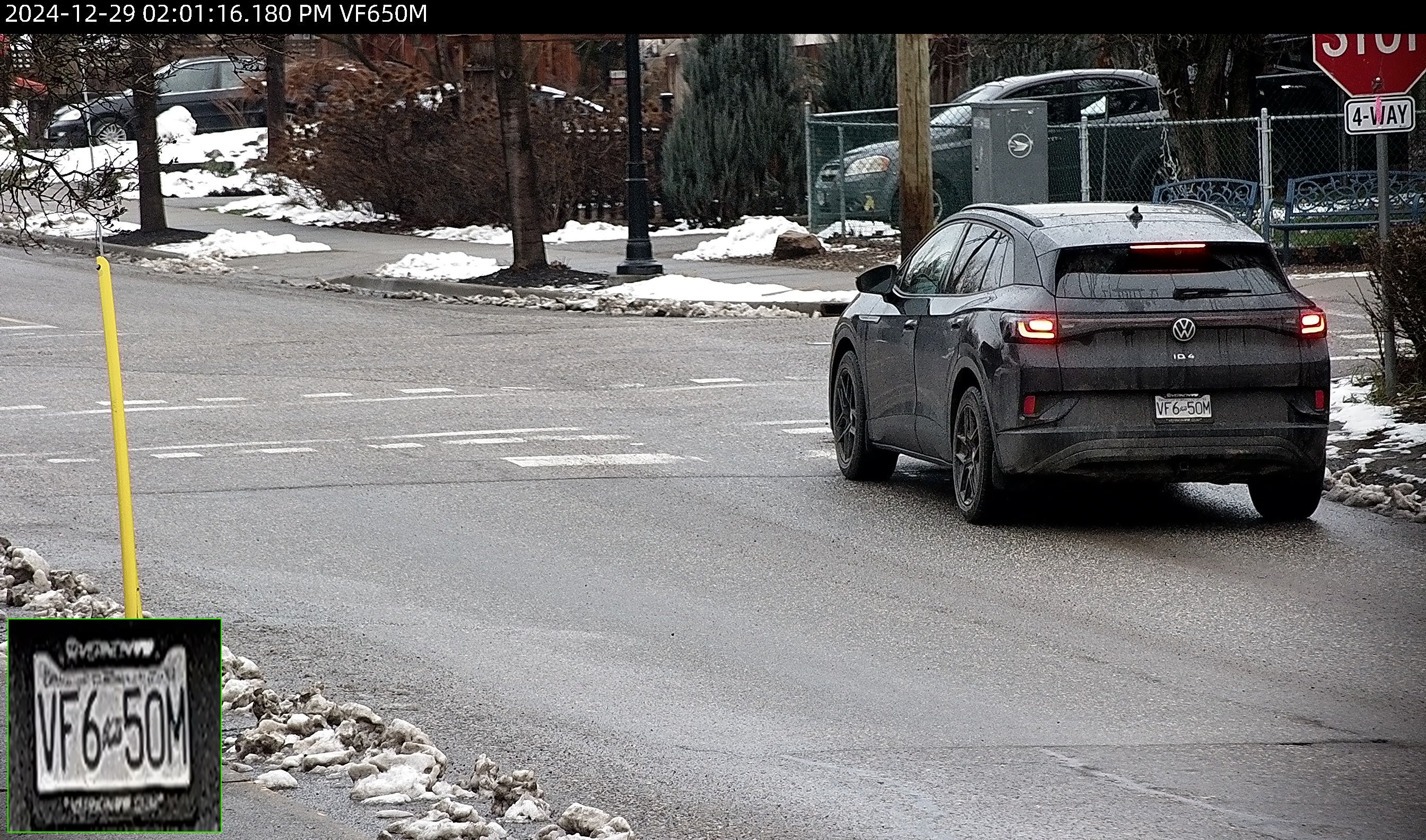

I capture about 5,000 plates a day currently, many I capture both the front and back plate. I keep images for about 6 months, or as my 1tb of storage allows.
Because I capture both the front and rear of vehicles, I use the data from both images to try and auto-correct incorrect plate matches.
