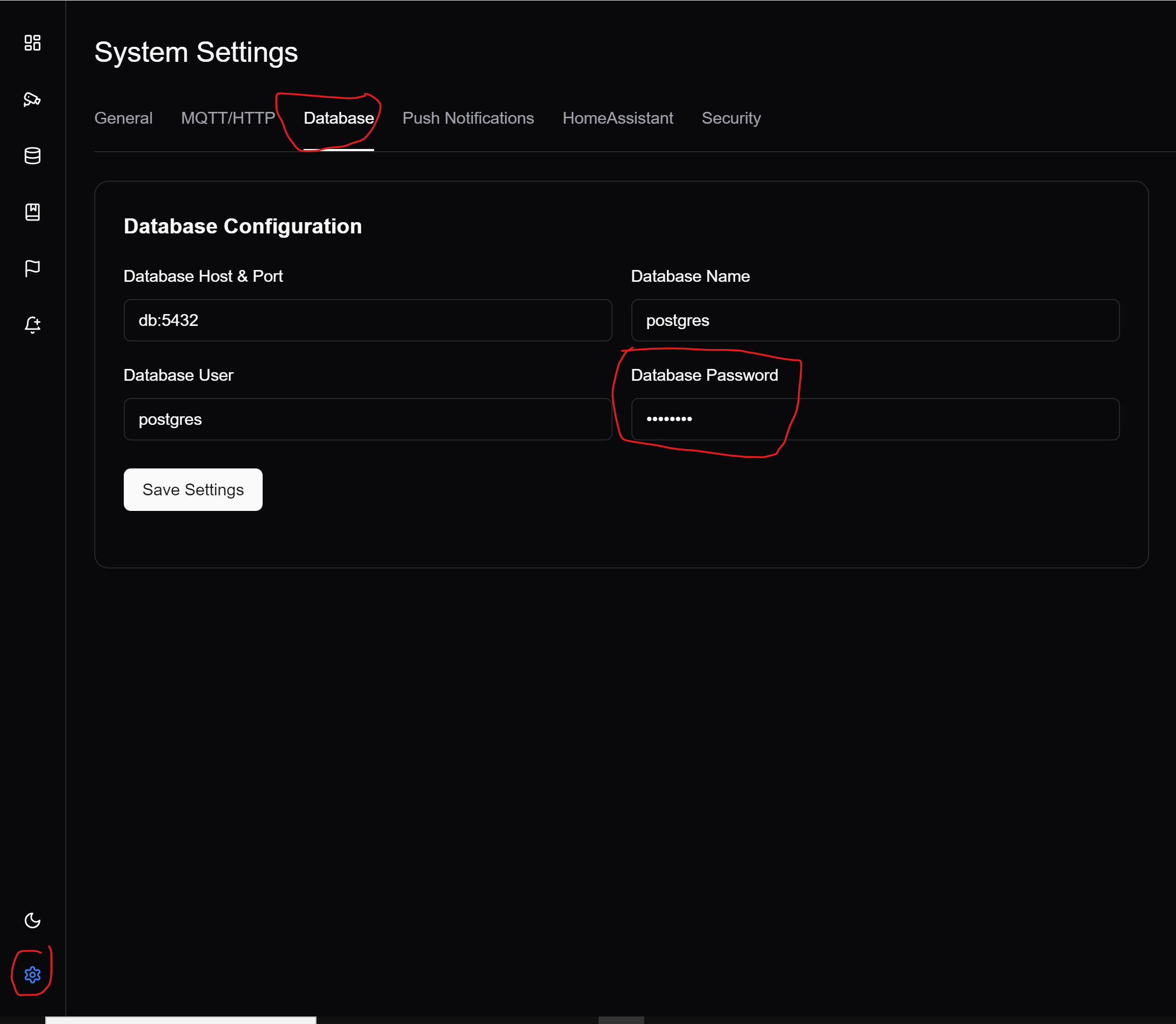

Thanks @MikeLud1, that did the trick! It also made me realize why nothing was going into the database previously because I only changed the default database password in one place and it looks like it needs to be changed in two places during setup. Do you know of an easy way to get into the database container to change the password?

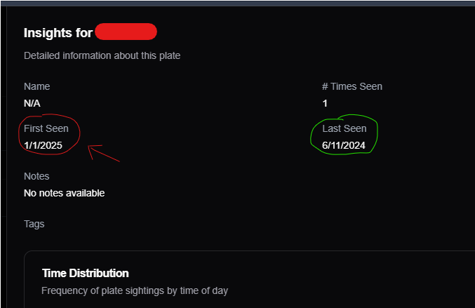

@algertc, I'm noticing that when I manually call the API passing older plate sightings, it correctly stores the last seen date as the timestamp passed in, but it puts the current timestamp as the first seen date. Is it possible to fix this?

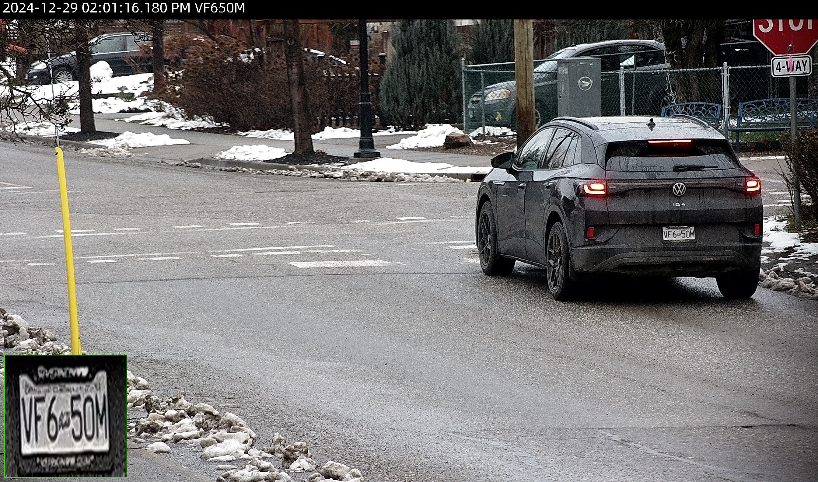

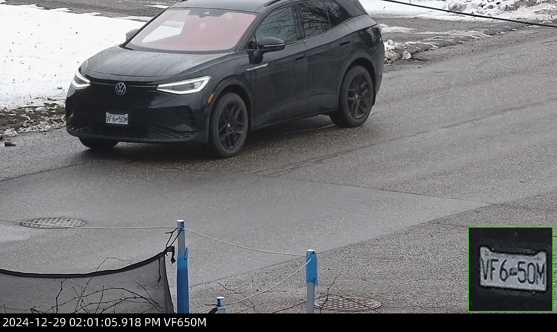

I would love to see the ability to recognize the make/model of vehicles. I can certainly contribute to help train a model.
I capture about 5,000 plates a day currently, many I capture both the front and back plate. I keep images for about 6 months, or as my 1tb of storage allows.
Because I capture both the front and rear of vehicles, I use the data from both images to try and auto-correct incorrect plate matches.
Reading the tire pressure information of passing vehicles is super nerdy, I love it!!

Unfortunately that only changes the password that is sent to the database, not what the database expects. That's how I was able to get it working by sending the default 'password' but I'd rather change it to something that's not the default.
You can do it by editing the postgres user with a query or with the CLI. You can connect under the exec tab of the container in docker desktop.
Bash:
sudo -u postgres psql
\password postgres
Enter password and new password and you should be good.
This is by design because the database automatically sets the timestamp when that record is received. As far as the database is concerned, that is the first seen date. To achieve the behavior you are looking for, it would need to go check all the records and compute this or let the user send it manually. I don't think either of these make sense to do for the majority of users, since you will only encounter this trying to bulk upload plates programmatically. What I would recommend is just adding something to your script to update the column in the database after it is set.

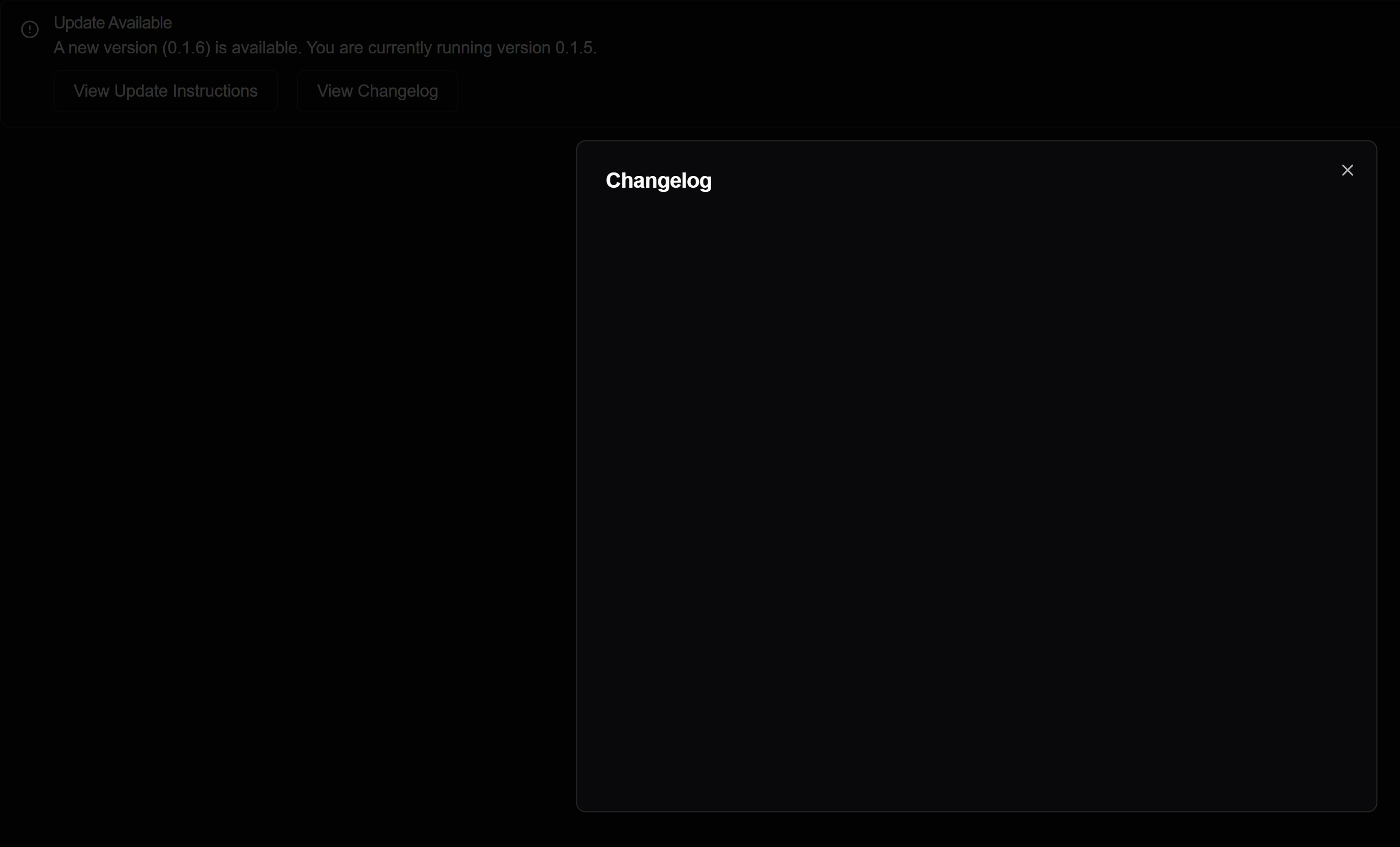

Nice update available:
  • Time format fix
  • Dashboard Redux: adjustable period, new visuals, top plates improvements, better responsiveness, clickable bars on chart, hover for quick look.
  • Ignore flag for known plates (Eyeball in known plates page)
  • Live feed can now actually be live updated. Switchable with toggle. Your page and scroll position are maintained on receipt of a new plate.
  • Ability to edit tag name and color
  • Sensible default sorting of database
  • Speed and loading improvements
I would definitely like to do more advanced notification rules. Sorting on live feed page will come next. I will add the untagged filter also @VideoDad
Pics below. I thought the hover for quick look thing was pretty cool.
