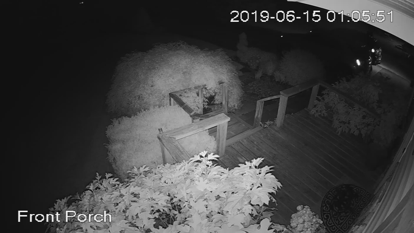

Here's a camera I have that is less-than-ideally situated. It's a compromise that serves two purposes. You can clearly see part of the side of the house and the side of the extended soffit over the porch.
It's not ideal, but it works.
+1 on this. It's gotta be a coincidence. Yesterday, I had to reposition the camera to avoid the soffit glare. Like your situation, now the IR illuminates the grass and not the actual path.
Next thought is to add some kind of base to increase the space between camera base and mounting area. Wife will not allow mounting it lower onto the porch columns which would be ugly to look in front of house. So, yeah, compromise.
