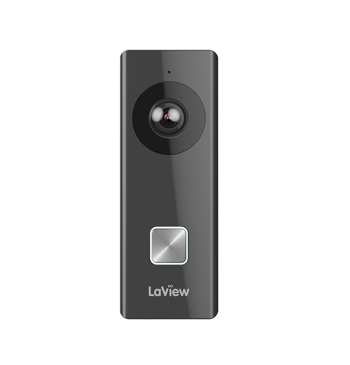

This looks like the defunct LaView (hikvision) 1080p doorbell that had terrible little quirks that were never fied. At least with the Hikconnect app it was secure/encrypted through China servers.
Which one would that be? Closest one I could find is this:
https://www.amazon.com/LaView-Doorbell-Storage-Pre-Installed-Detection/dp/B079Q435KL
Specs are different and the micro SD slot is on the side instead of on the bottom and the mic is not centered above the lens so it's a different PCB at least.
Yes that is it. I like it due to the hikconnect app you can use as it gives me more sense of security. But you can see here about the quirks it has:
Sweet! LTS is releasing an ONVIF compatible doorbell with SD card slot and 940nm IR
Good, I'm pretty sure this is a very different product then since many of the specs are different.
