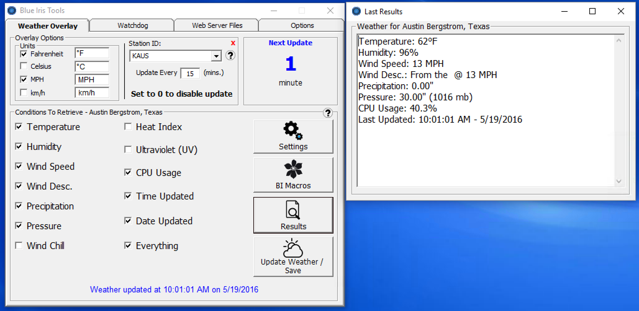

As for the BIT issue...I have the weather configuration for here in Austin. Here is a screenshot of the setup and the most recent results:
Now my issue is...these results are incorrect. I run a home automation system (Indigo) that has a plugin for WUnderground data access and I set up the API, etc.
It's been raining in Austin off and on for a few hours now and the precipitation reads 0.00 in BIT but Indigo has it at 1.51 for the day.
BIT doesn't seem to pull down the wind direction...and the speed said 13mph when Indigo was reporting 18mph
It's not a big deal...in theory I could script Indigo to write the TXT files to the Blue Iris server. I'm thinking about doing this anyway so I can overlay each room's temp/humidity on the matching camera view based on the Z-Wave sensor readings in that room.
I just thought I'd mention these 2 things I;m seeing on my system in case others do too and help bring awareness to them...and if no one else is seeing this, maybe get a facepalm moment where I learn I've got something configured wrong. (I have no problem admitting when I've messed up on something...all part of learning.)
